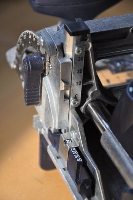

Zo, ik heb even doorgezocht over die 10mm en een mooie uitleg gevonden op de website van halfinchshy.
http://www.halfinchshy.com/2013/07/domino-df-500-or-domizilla-xl-df-700.html
"Fence Height
The height refers to the fence distance to the center of the mortise. Nominally, the 500 should be able to get to 5mm from the center although some fences require a bit of filing to do that (mine for example, but mine is an original first-gen fence). If you have a problem lowering your 500 fence to 5mm, give this article a read.
A limitation of the 700 is that you can't get that close to the center. With a 10mm minimum distance, you can only center the mortise on 20mm or thicker stock. Personally, I've never had a problem putting a mortise slightly off-center and actually encourage that for easier assemblies. However, the 10mm distance means 3/4" ply is about the minimum you can use even with an off-center mortise.
The Seneca DomiShims (or even your own shims) can apply a certain offset to the fence making that 10mm setting be, well, 0mm if you had a 10mm thick plate. The DomiShim for 1/2" stock is 9mm thick so you can technically set the fence to 1mm from the center, but then you'd ram your bit into it. But the point is it effectively gets you a lot of range on the fence height. Granted, installing the DomiShim isn't the fastest thing and, currently, the final version of the shim and fence height gauge are in some flux. Ultimately, you'll be able to use it or some shop-made shim to center your mortises on thinner project stock."

Huib, ben ik toch niet helemaal eens. Heb net een badkamer meubel gemaakt in 18mm MDF en alles met de DF700 + adapter+6mm frees gedaan. Viel heel goed mee en heb nooit gedacht dat het te groot was voor het werk. Voor dunner plaatmateriaal is het mss wel het geval maar ook hier al schuiven gemaakt in 12mm maar dan moet je wel wat aanpassen (vooral hoogte). Tot nu toe is het enige wat ik ben tegengekomen wat je wel met de DF500 kan en niet (gemakkelijk) met de df700 is een schap in het midden van een kast juist op de lijn krijgen. Met de df500 en/of lamello kan je het schap positioneren op de zijkant waar je de boven(onder) kant wil hebben, vervolgens klemmen op elkaar en dan de domino laten rusten op de zijkant en het schap infrezen en nadien de zijkant infrezen door te steunen tegen het schap. Met de DF700 lukt dit niet omdat de hoogte tussen de onderkant en het midden van de frees te groot is tov de dikte van de plank. Ik moest maar 1 schap zo doen dus besloten om nog eens de lamello vanonder het stof te halen. Moet nog eens nadenken hoe we dit in de toekomst wel kunnen met de DF700.

@MaartenS: heb het mss niet zo goed uitgelegd. Ik heb vroeger geleerd dat als je twee MDF platen haaks op elkaar wil monteren, je deze positioneert, en vervolgens een van de twee kantelt zodat ze op elkaar liggen. Vervolgens zet je dan de lamello of domino met de onderkant op de plaat en frees je in de andere plaat. Daarna zet je de machine haaks met de onderkant tegen de bovenste plank en frees je de onderste plank. Dit gaat niet met de domino xl omdat je dan te hoog uitkomt. Hier is een manual voor de df 500, op pagina 17 laten ze zien wat ik juist bedoel.
